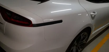

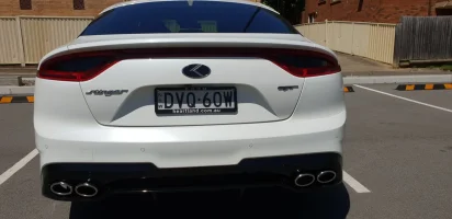

  15. ShannonC
    ShannonC Australia Stinger Enthusiast
    Nice job @Chucky
    Black vinyl from craft shop or paint section of hardware store is the go. Cheap and easy. Also works well on side reflectors.

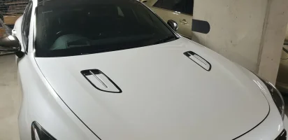

  17. ShannonC
    Considered white but went with black. I've got a roll of white wrap left over from when I did the bonnet vents so can experiment at any time.
