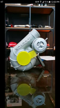

  5. Kamauxx
    4,551
    1,670
    [​IMG]
    • Like Like x 1
  6. AV8R
    AV8R Australia 5000 Posts Club!
    Ah, those turbo blades look a bit bad!
  7. Kamauxx
    4,551
    1,670
    The dealership noticed the damage when they received the car from Kia. They pulled the engine to repair it. One of the techs posted photos here.
