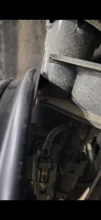

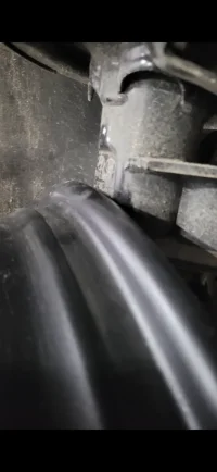

So I recently bought some bbs unlimited wheels the sizes are:
20x9+36 for the front 255/35/20 tire
20x10+41 for the rear 285/30/20 tire
When the tire shop went to mount them they said the wheel/tire and the strut are going to be scraping but I have seen numerous people running exactly what I’m trying to run without issues
Need help ASAP any input is appreciated!!!
Fitment is flush as of right now and I would like to keep it flush

It's the front that's rubbing right? I don't know that I've seen that specific size, but a 9" +36 adds a half inch of wheel inside & out, then the increased offset shoves it in 2mm, so you have about 14.7mm less clearance inside, and the outer edge is 10.7mm further out.
We know the stock wheel can take up to a 20mm spacer to be flush with the fender, so you could do a 5 or 10mm spacer without shoving the outer edge too far out.
In the rear, your 10" +41 adds 3/4" (19mm) inside and out, then the lower offset shifts you outward about 5mm. So your inside edge is about 14mm further in, and your outside edge is about 24mm or just shy of an inch further outward. Same deal as the fronts, a 20mm spacer puts the outer edge pretty much flush with the fender.
With that in mind I'd add a 10mm spacer up front, which should also make the wheels match a bit better in terms of flushness.
