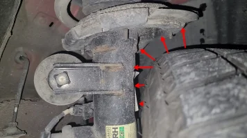

I need help trying to figure out if GT-F Lowering Springs won't cause me any fitment issues before I buy them. Im running 20 inch rims with the rear tire width of 275 and profile size of 35 and the front is 255/35. Question is by lowering the car by 1.15 inches, will the front tires be closer to the structs as far as rubbing? In the picture below its already fairly close.
Springs don't cause fitment issues...
If you are currently running those rims/tires (with any springs) - and there is no rubbing while driving over bumps - then changing the springs will not cause any rubbing. You can test this by driving over some bumps today!
if there is no rubbing through the complete suspension travel - there will continue to be no rubbing, through the complete suspension travel, with the new lowering springs (any brand).
This distance is completely independent of the spring (ride height)
This is a winter tire image. Whatever the clearance is here at any ride height, it will remain the same clearance through the suspension travel.
