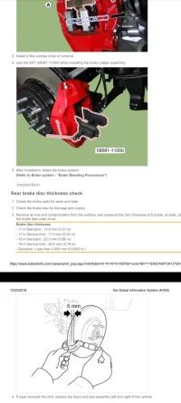

Anyone know how thick is the limit on our rotors ? Just read there's a stamp on the edge of the disc ? If I measured mine right, my rear are .9" or 23mm.
Your measurement is thicker than the standard.
I Stung U
Ya, I found that thanks. I'm gonna double check. I had measured a bit deeper than the edge and got .9, which is still more than it's suppose to be new, so that's odd.
I Stung U
