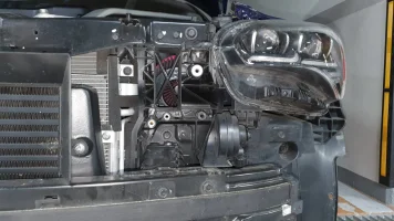

    I'm working on my first 3D printed mod and chose to design something to replace the stock intake snorkels that sit behind the bumper cover.
    This is somewhat of a hybrid between the Velossa Tech Big Mouth and the JT intake cutouts. I didn't like the fact that you had to remove the entire radiator shroud with the VT, but the simplicity of the design was appealing. The JT intake requires you to cut ports into the shroud rather than remove it, but its only available as part of their kit.
    So...I started prototyping models and while I haven't quite reached a final design that I'm happy with I thought that I was far enough along to share. All of the prototypes were printed using a large extruder with low resolution in order to speed up the design cycles. The final print will be much higher res and so should be much smoother.
    Version 3 (still working on the overall size and fitment up to the shroud)
    Left - version 5/Right - version 4 (Fit is getting better, but still not quite right)
    This is a close-up of the left side. You can see the air channels directly into the airbox here.

    Could you show more how you attach it to the car?
    • Like Like x 1

    Location:
    Seoul
    BTW in my case it needs to be extend a little bit less on the inside because of the wagner intercooler.
    Thats why I was thinking of modifying myself that side if its not too hard to do.(have no clue)

    98
    76
    It's not something I'm ready to try at moment, but it sounds like a neat idea, and it should be doable. I'm assuming you'd want to mount your air filters up front behind the bumper cover?

    98
    76
    I have a new set to throw on once the weather cooperates. I'll grab some more photos for you then since I'll have everything pulled apart.

    98
    76
    Holy cow...that is a big intercooler. If you have 3D CAD software and some patience its not too bad, but getting the measurements precise can be tricky. Are you thinking you would want it to more or less go all the way forward to where the original shroud meets up with the bumper cover?
