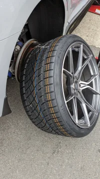

So I'm running 285/30/20s and wondering if I can squeeze a 285/35/20 in my fender well anyone try this?
Pic is the 30 sidewall
Doing the math, your combo now is 26.14" tall. Your new combo will be 27.91" tall. That's a difference of 1.7".. So... Half that is .65" on either side of the center hub. While the 30's are mounted, measure front and back with the wheel straight, and then left and right for clearance. Not 100% but if you're really close to rubbing now you will have your answer.
(285mm x .30 = 77.4mm) (77.4mm x 2 = 154.8mm) (154.8mm \ 25.2 = 6.14") (6.14" + 20" = 26.14" tall)
Plug your numbers into this:
Thanks decided to stay with the 285 or I would have rubbing issues good calculator however
