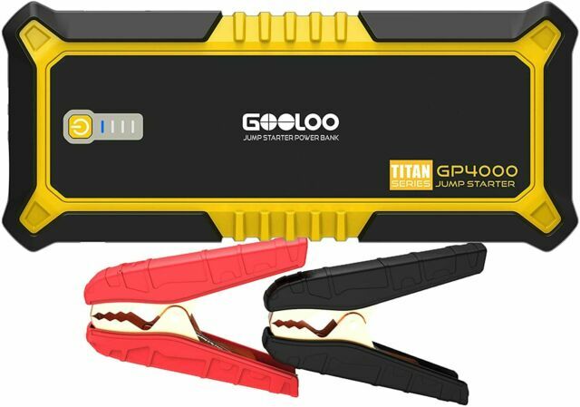

i will just add that you should not jump-start a modern car - too many computers and electronics in them that can get damaged by a power surge.
everyone should have a lithium ion rechargeable jump pack in their car. for less than $100, you can get 5 or more jumps before they need recharged, and even power your cell phone in a pinch.

This one looks pretty good & currently on specia.
I've got a Noco Boost GB70 jump starter pack. Works really well, even on my diesel Jeep. You're right about the price down here though PxbVic.
Yeah for now I've picked up a similar ebay unit, as once the battery is replaced I shouldn't need it... They are cheap, but buyer be ware, you get what you pay for, I'm happy to take a rick on a cheaper unit... Thanks for the link..
Yeah cheap arse me went even cheaper than that :D:
