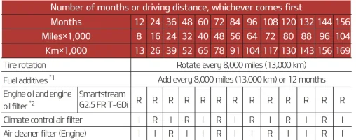

The owners manual suggests as follows for normal duty. How often are you replacing yours?
"More often" under the severe use category. The car get a combination of both. Not driven in dusty or construction like, or off road environments. Just general city and mostly highway.
Currently a bit over 2 years old with just over 10K mi. Filter (single) has some debris but overall looks like it's good for another 10K. I have a feeling the 3 pack of filters I ordered will last me a decade! I haven't pulled the cabin air, but imagine that's relatively clean too given car is garaged. Will replace that next spring.
