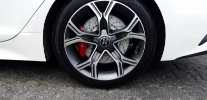

So after dealing with the issue of the OEM pads and leaving deposits on the rotors I switched to aftermarket pads. My issue now is the sound the pads make. The squeaking was fine for the first month or so. Now it's actually getting to me. I have the stoptech pads in the front and EBC red stuff in the rear. I had to get different set of pads for the front and rear because of the limited availability at the time. I did not apply an lubrication to any of the pads and i'm not sure it would of made a difference. Is it the pad material making the noise or is it possibly from some other way it's being held on that I can reduce the noise?
